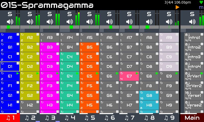

Launcher View
The launcher is the zynthian's sequencer main view. You can always access the launcher by pushing the PAD button. You can also push BACK repeatedly until reaching it.
From the mixer, you can access the launcher by pushing BACK. Similarly, from the launcher, you can access the mixer by pushing BACK. Launcher and Mixer are, indeed, a single view with 2 modes.
The launcher is a grid where columns match chains (mixer's strips). Rows are called phrases, being quite similar to Ableton Live's scenes. Cells can contain step patterns or audio clips, except the main column that contains phrase launchers.
Initially the grid will be empty, showing the main strip alone. When adding a chain, a new column is added to the grid. When deleting a chain, the associated grid column will be removed. Note the associated patterns are not deleted. They are associated with the MIDI channel and if you create a new chain with the same MIDI channel, the removed patterns will be available again.
Cell selection
The cursor is a yellow box highlighting the selected cell. You can move the cursor by rotating knobs 3 & 4:
  • Knob 3 => Vertical move => Select phrase
  • Knob 4 => Horizontal move => Select chain
